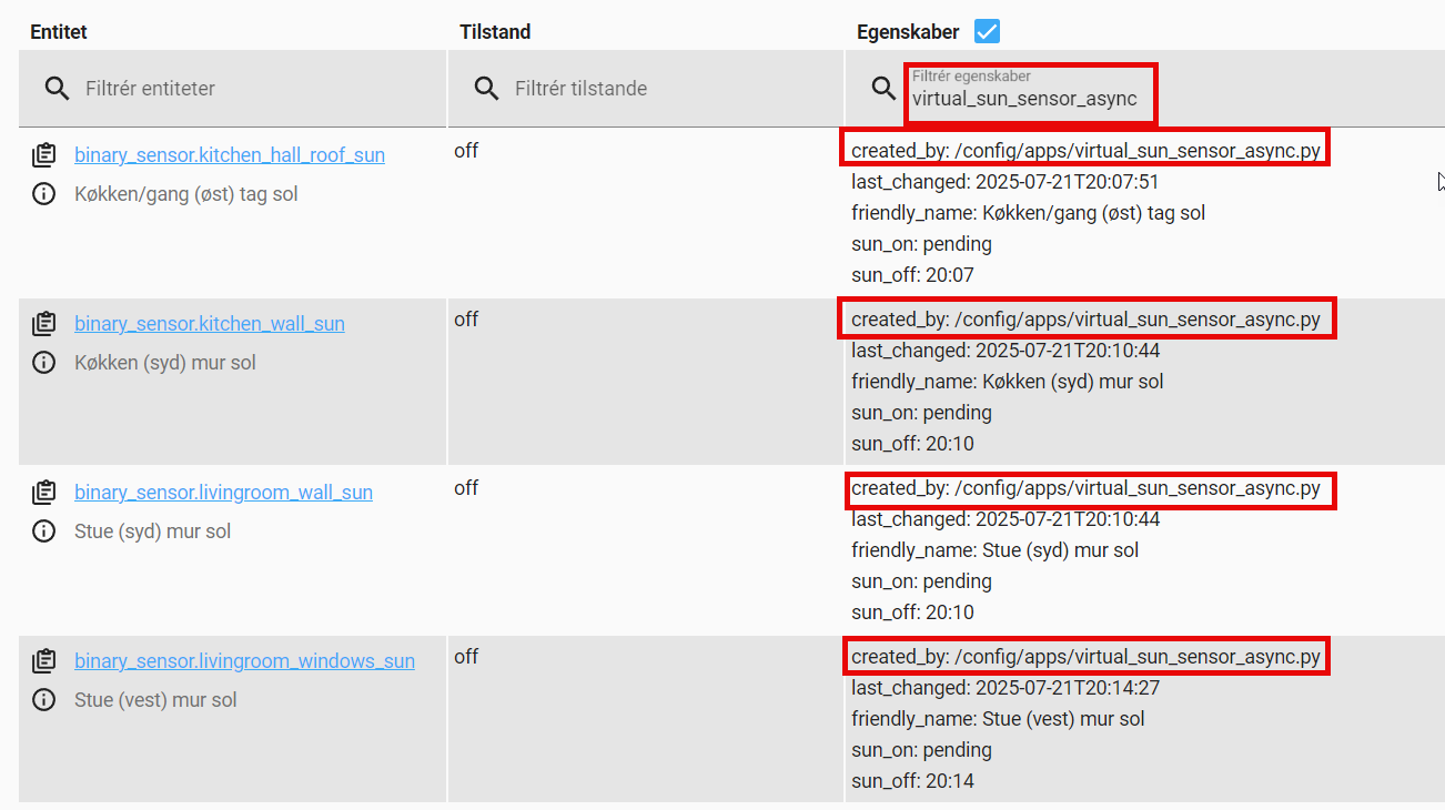

Protip: Filter entities by AppDaemon class?
I find this quite useful when quickly filtering entities by their origin.
eg. a class that creates one or more “virtual” sensors.

  async def create_or_update_sensor(self, virtual_sensor_name, friendly_name = None, value = None, icon = None, unit_of_measurement = None, device_class = None, entity = None, append_attributes = None):
    class_filename = await self.get_class_filename()
    final_attribs={
            "created_by": class_filename,
