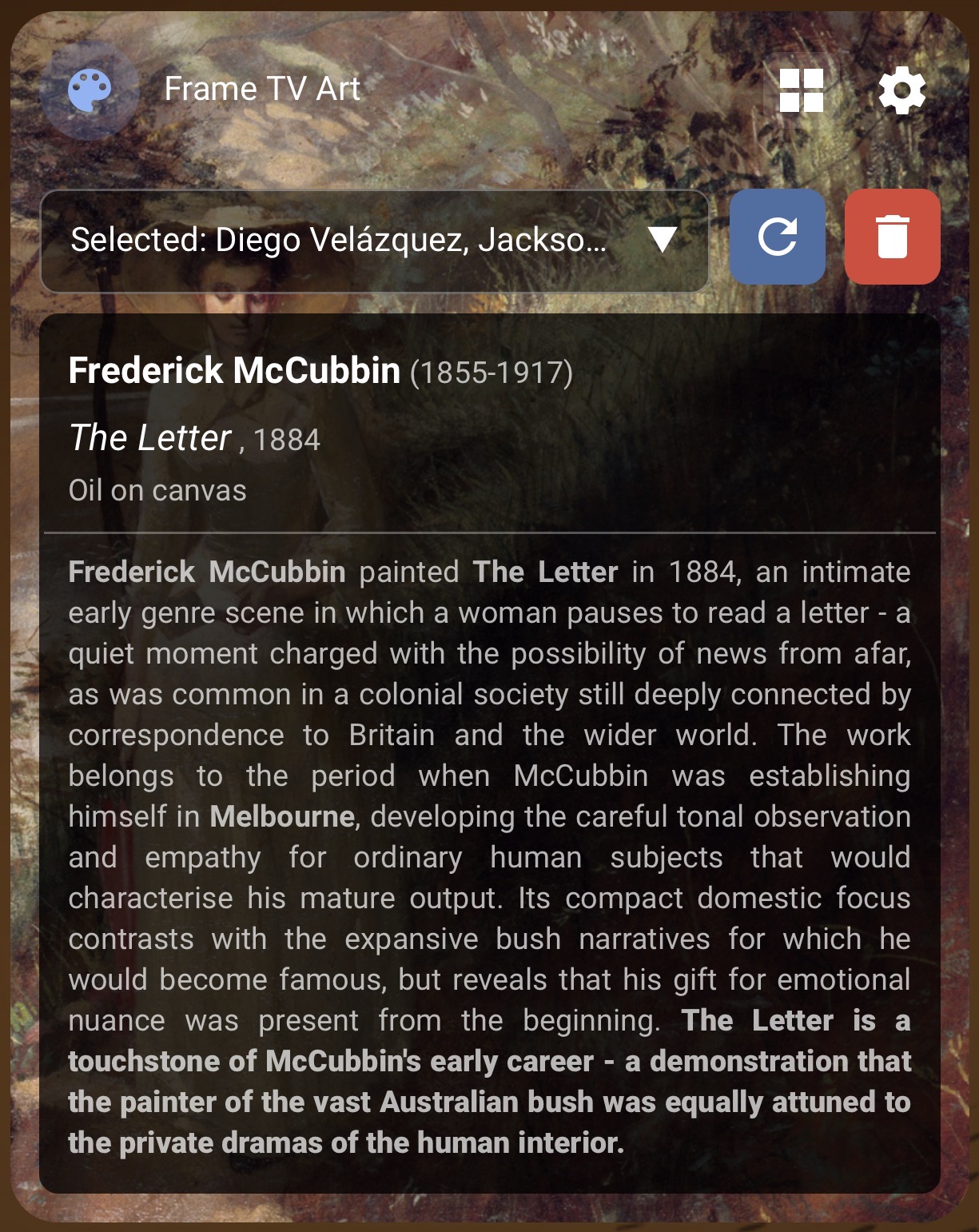

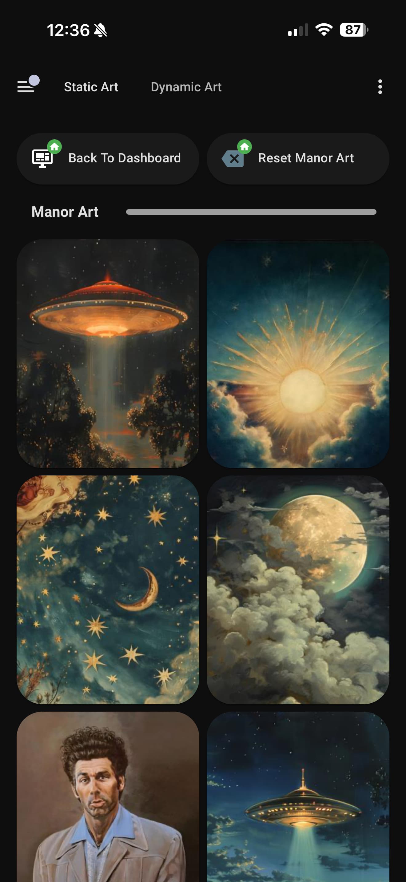

After years of battling to get my Samsung frame TV (which I only purchased for art mode) controlled by HA I finally admitted defeat via supported routes and built my own custom solution. Setup a local art server, wrote a custom HA integration, and put together a linux mini-pc that boots directly into a custom “art mode”. How it works is I can upload art into the media section of HA when then displays on my art dashboard I made (accessible via the app and web interface). When I select an image, it triggers the art server to send the art directly to the Samsung frame TV. I set it up this way so I can control multiple frame TVs independently or all together. The only down-side of doing things this way is you lose the Samsung art modes dynamic screen adjustment, but I found that messing with the eco settings dynamic brightness settings (among others) you can get it so basically act the same way.
The major benefit here is not having to use that garbage Samsung app to change my art, I can now schedule art based on any other sensors, and I can do motion art as well.
Finally got my frame tv’s setup the way I want. Wish Samsung software wasn’t such garbage.
(the HA app dashboard that delivers the art on a tap)

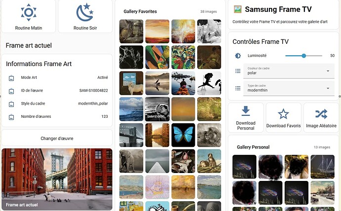

Hi I’ve integrated the new art.py in ollo69, works great with my 2024 frame:
it’s a fork of ollo69… TheFab21/ha-samsungtv-smart: :tv: Home Assistant SamsungTV Smart integration with SmartThings API Support. enjoy and let me know

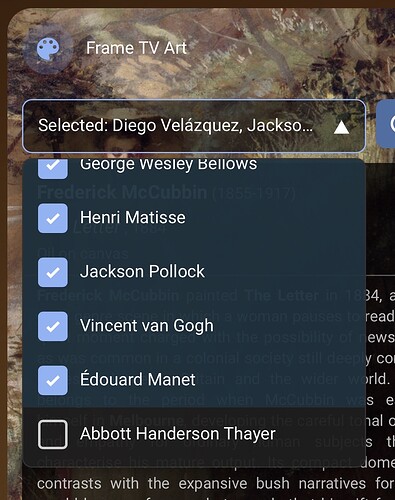

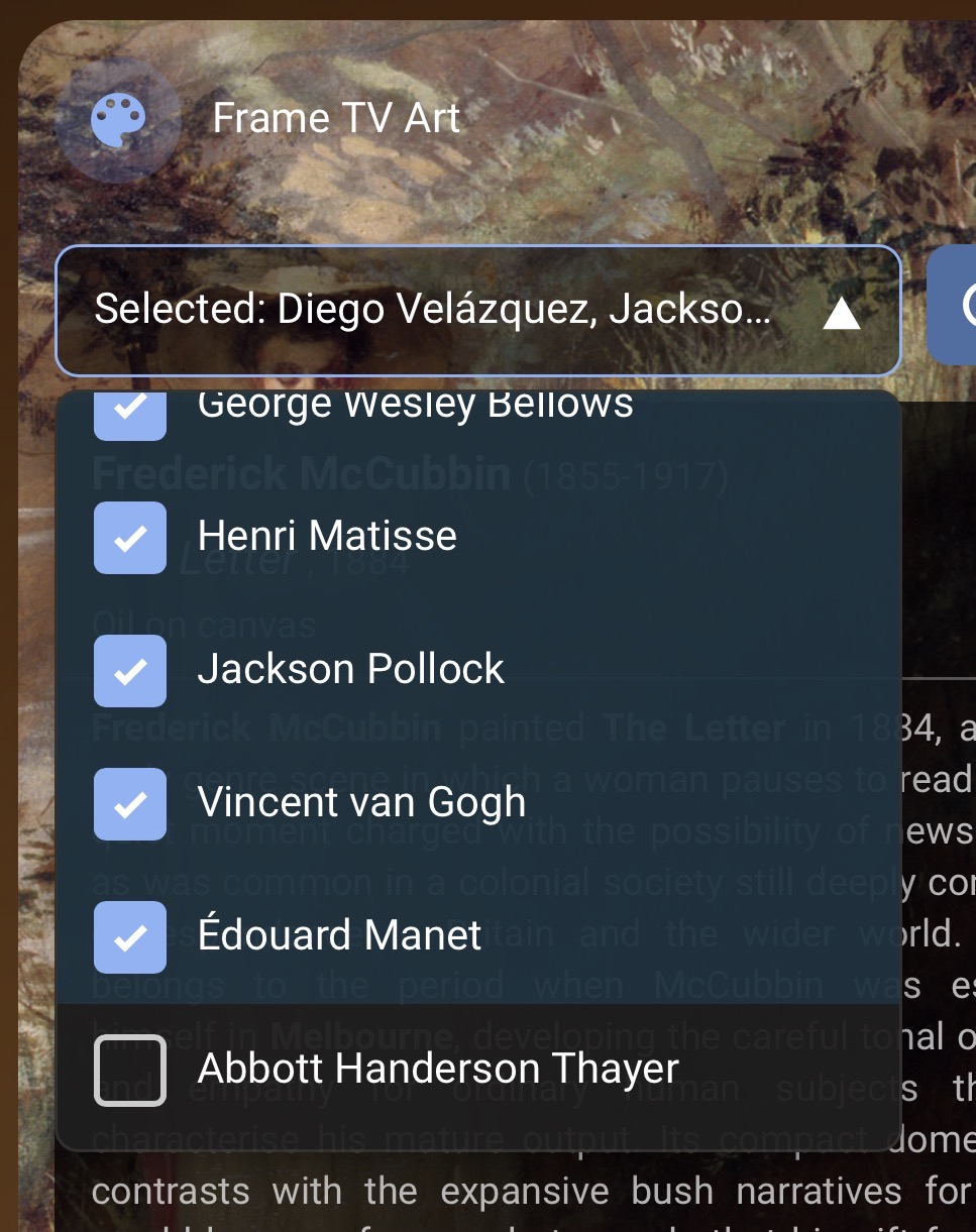

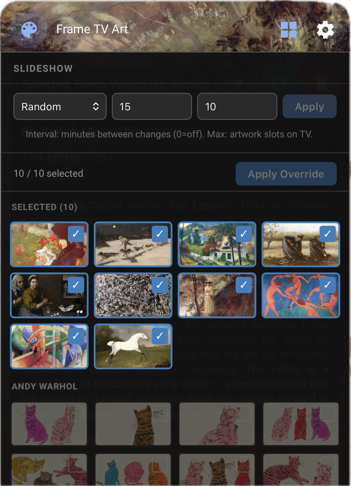

Just released v0.2.0 of my combo uploader and ha card for art mode. You can populate your own artwork collections or use the ones I provide and maintain with full meta data, or a combo of both.
