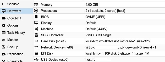

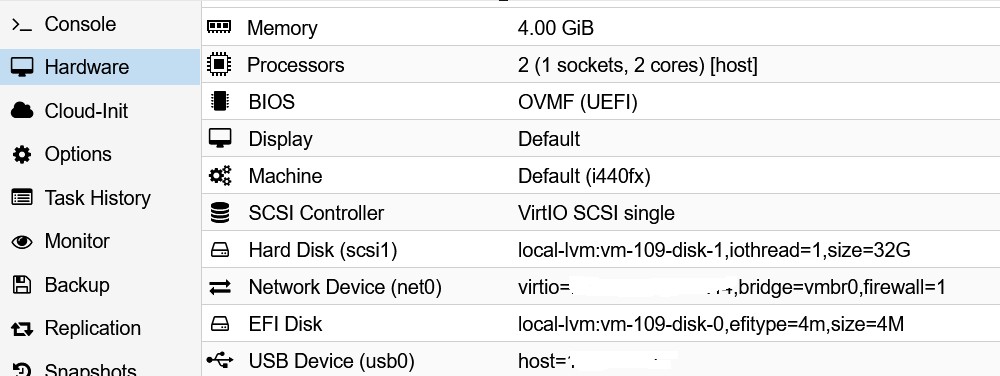

Hello Franksfin,
it worked like a charm for me in PVE 9 with this config
Nota Bene : don’t create a 32GB disk attached to your VM, the disk is in the image itself.
As far as I remember, I first push the OVA file to /root and then extracted it with a tar command such as : tar -xf HAOS.ova
once it’s done, you will have a vmdk file if I remember well.
Then you import the HAOS.vmdk file with the command
qm disk import 100 HAOS.vmdk local-lvm -format raw (100 is here an example for VM ID, adapt it with your value)
Once the 32GB disk is displayed in your VM, you must ADD it with the GUI, if not done, the disk will not be really attached to your VM.
Then you just have to modify your boot sequence and it should work.

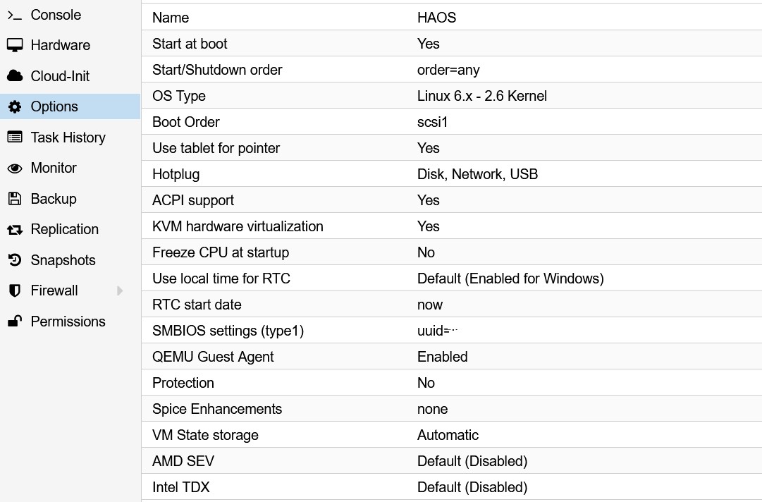

the second screenshot about the config
