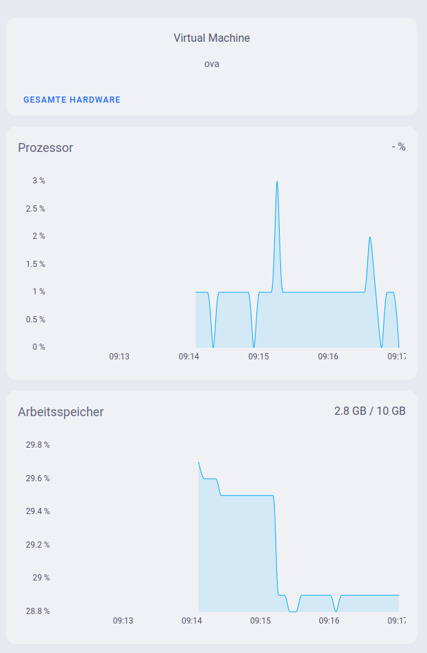

Same to me. I am in doubt that this can be ignored as written by someone. However, I am open t get a better explanation why this can be ignored. What I do not want is that HA/proxmox starts cashing and gets slow. In addition to that, at least once I recognised data corruption. However, I am not sure whether this is because of the high memory assumption.
