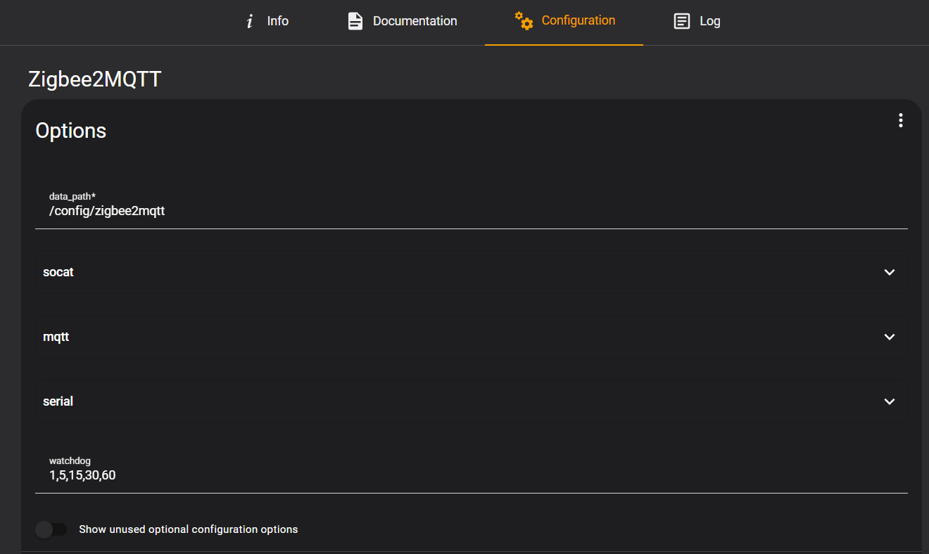

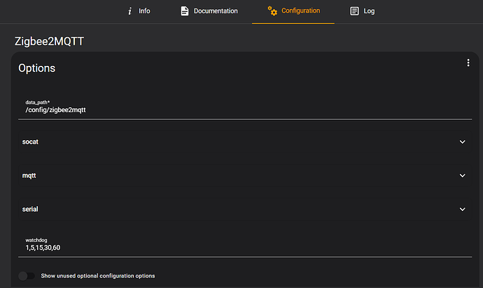

Same as @nightfever, I do 12 hour snapshot backups on Proxmox (SLZB-06p7) and never had any issue. Before you figure out the reason, you could enable the watchdog for the app. Remember to fill out the checking intervals (in minutes):
Oh, I was not aware of that enhanced watchdog setting, I’ve used only the normal Watchdog switch of the Addon - sorry, App - which is geeting deactivated after certain numer of failures.
With the Setting 1,5,15,30,60 I can come over the backup time. Z2M is starting afterwards properly.
