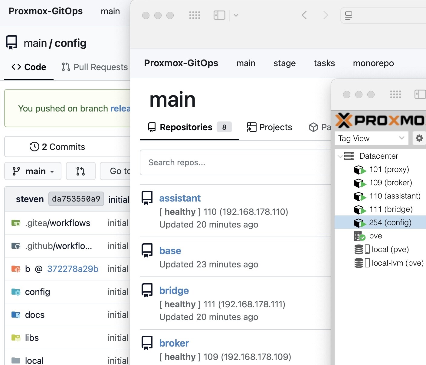

Homeassistant
Originally, I just wanted to automate my homelab using Infrastructure-as-Code - without to repeat myself.
My homelab however is actually a Home Assistant stack (with broker and bridge), which therefore reflects container definition examples as well as the homelab containers I am running myself:
Proxmox-GitOps itself is a completely generic container automation approach: Whether to use for the built-in Home Assistant stack or to create and automate container via IaC using the generic underlying base (Debian LXC 13) with preconfigured pipelines and (optionally) its applied infrastructure libraries, so container definitions can be separated to only hold its application logic:
- Home Assistant: Proxmox-GitOps/libs/assistant/recipes/default.rb at 75875f776a8d683187edb9410d7bfb097db6d898 · stevius10/Proxmox-GitOps · GitHub
- Zigbee2Mqtt: Proxmox-GitOps/libs/bridge/recipes/default.rb at 75875f776a8d683187edb9410d7bfb097db6d898 · stevius10/Proxmox-GitOps · GitHub
- Mosquitto: Proxmox-GitOps/libs/broker/recipes/default.rb at 75875f776a8d683187edb9410d7bfb097db6d898 · stevius10/Proxmox-GitOps · GitHub
