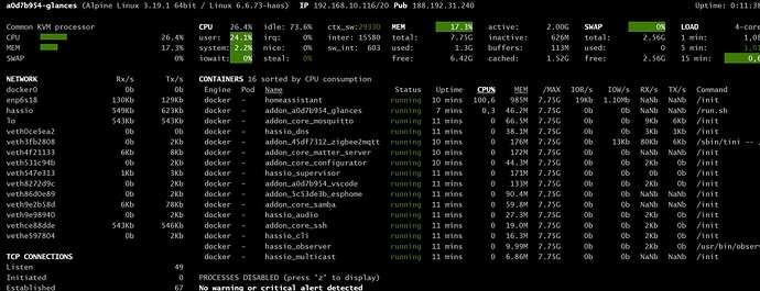

Glances inside Home Assistant tells me, the homeassistant container itself is always at 100%

I managed to install py-spy because the process, always at 100% was python3.
Here are the two logs, 120 and 300 seconds long.
TBH I don’t know how to read these logs…

2 Days later and I found the solution.
I had a python script inside my python_scripts folder which i put there some weeks ago aperrently…
I deleted it and suddenly everything back to normal!
