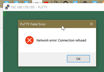

I created a key-pair on my windows machine and placed the public key of that in the config of the Terminal & SSH configuration of the hass addon. Now if i open a putty session, i’l get a login screen. But as soon as i enter the login name i’l get a connection refused message.

Ok, then you must set the port to 22 in the configuration of the SSH addon.
Yes i know, and that was what i did. Otherwise i would never had the login prompt when i connect to the VM instance… No that is not the problem, it is on de VM itself.
With port 22 set and no ssh key in the addon conficuration i get this error message:
Next, I tried it with a public key in the addon configration (which i created on Win10).
But that geve me an other error message:
