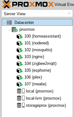

Another reason I like to run detached from HA is, if/when Home Assistant is down all of my critical automation’s keep working! I utilize Node Red, MQTT and Z2M in separate LXC’s. This allows me to shutdown, update or even try new things with HA and not affect the family.
I also like having each so called add-on backed up separately.
