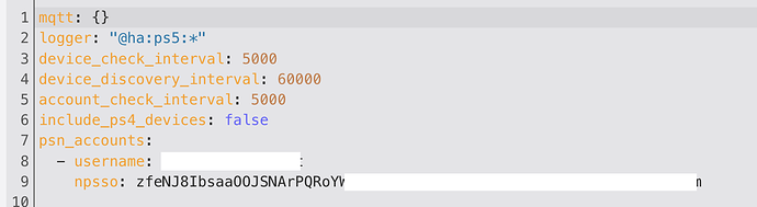

i am stuck at setting PSN account update.
Add-on doesn’t create a new sensor.my_playstation_activity for me.
What should be used as username?
Screenshot 2022-08-21 at 12.40.14
Is my configuration correct?
It won’t literally be called sensor.my_playstation_activity but the name of your playstation +_activity.
If you’ve done all the setup correctly (config add-on properly and have a MQTT broker installed) the best way to find your entities is to search HA’s devices using the name you gave your playstation. By default something LIKE: PS5-067.
