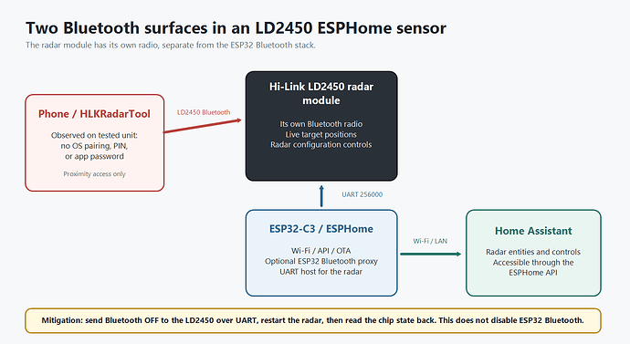

On my unit, HLKRadarTool connected directly to the radar with no OS pairing, PIN,
or app password. It showed the live target map and writable configuration.

Also note the two separate radios: the ESP32 may run Bluetooth Proxy or beacon
tracking, while the LD2450 has its own Bluetooth radio for HLKRadarTool. Disabling
one does not disable the other.

ESPHome’s native ld2450 component supports the required switch:
ld2450:
  uart_id: uart_ld2450
switch:
  - platform: ld2450
    ld2450_id: ld2450_radar
    bluetooth:
      name: "LD2450 Bluetooth"
Compile and flash that configuration, then turn LD2450 Bluetooth off in Home
Assistant. ESPHome sends the chip command, restarts the radar, and reads its state
back. Verify that the switch returns off after restart and HLKRadarTool can no
longer connect. Keep UART recovery working because the phone app will be unavailable
until Bluetooth is re-enabled.

For reference, my tested custom path enters config mode, sends 0xA4 off, restarts
with 0xA3, and queries 0xA5 for read-back. On LD2450 firmware
2.04.23101915, the off state survived a power cycle, ESP reboot, and later
ESPHome OTA flashes. An LD2450 factory reset is a reason to check it again.
