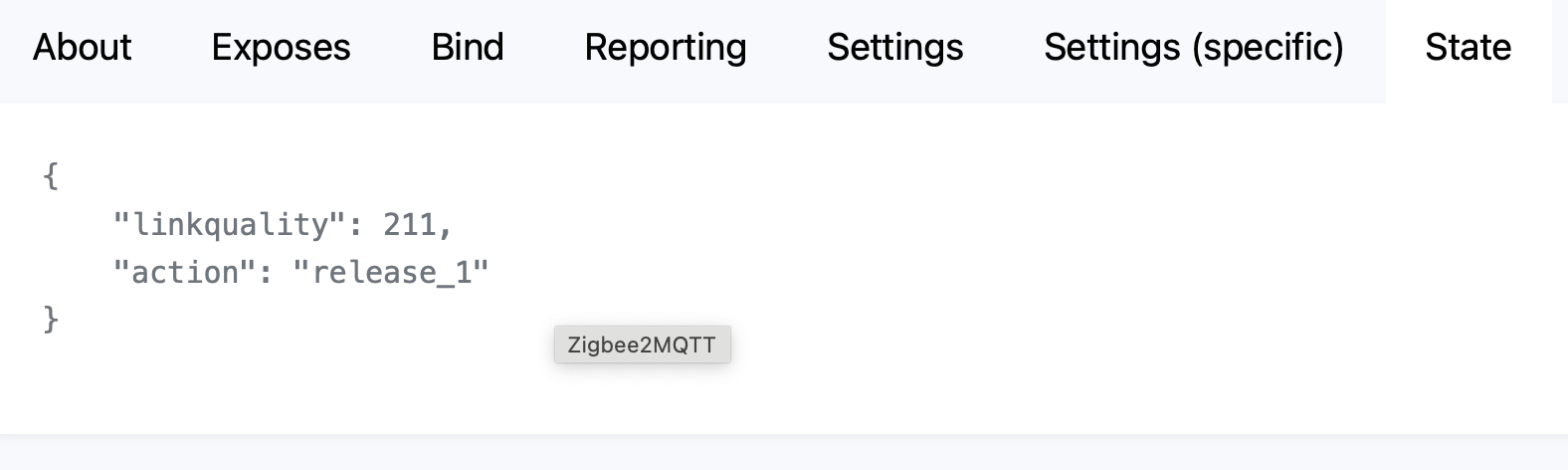

Once the pairing is confirmed, z2m console will show the last action under state
And now that, that works, the blueprints also work
