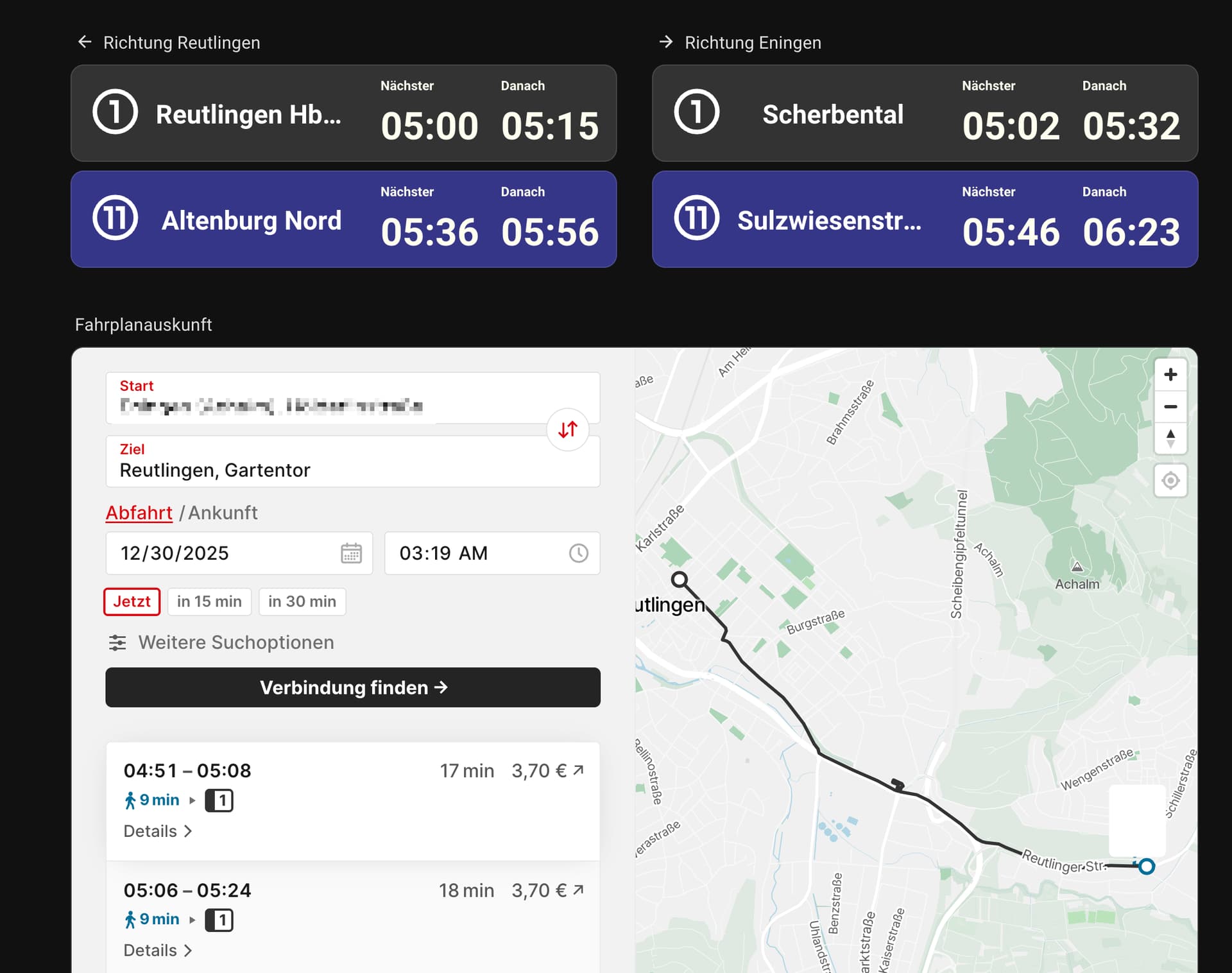

There’s a lot of refinement left to do in the code, especially some redundant styling that I haven’t had a chance to go over. Before I start that, I want to figure out the overall formatting as I’m not completely happy with it yet.
Essentially, I want the service times to show minutes when it’s less than an hour away, or the arrival time if it’s more than an hour. It’s been tough getting this to look nice - a big font for the number of minutes looks best, but displaying the time in the same size doesn’t look good and takes up too much space. On the other hand, having the time a bit smaller looks a little incongruent.
There’s also the issue of the width of the next/following columns. It looks a little messy when they don’t line up across multiple services, but having them a fixed width takes up a lot of the space for the service name. Shrinking either the name or the minutes/times has been making things look less nice but I think this is where the most tweaking eeds to be done. Very keen for feedback from someone with an eye for UI design.

so nice, thank you @Nassau — I gave your code snippet to claude-code and it helped me build my own version for the two bus stops around my house.
thank you for sharing
