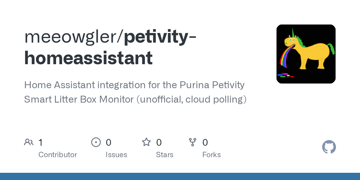

I’ve built a custom integration for the Purina Petivity Smart Litter Box Monitor:
Install through HACS as a custom repository (category: Integration).

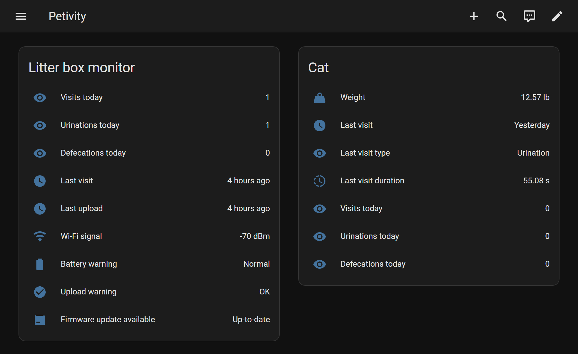

What you get
  • Per monitor: last upload, visits / urinations / defecations today, last visit, battery and upload warnings, firmware-update flag, Wi-Fi signal
  • Per cat: weight, last visit time, type (urination / defecation / both) and duration, daily counts
  • A Visit event entity per monitor that fires once per new visit (cat, type, weight, duration), handy for automations
