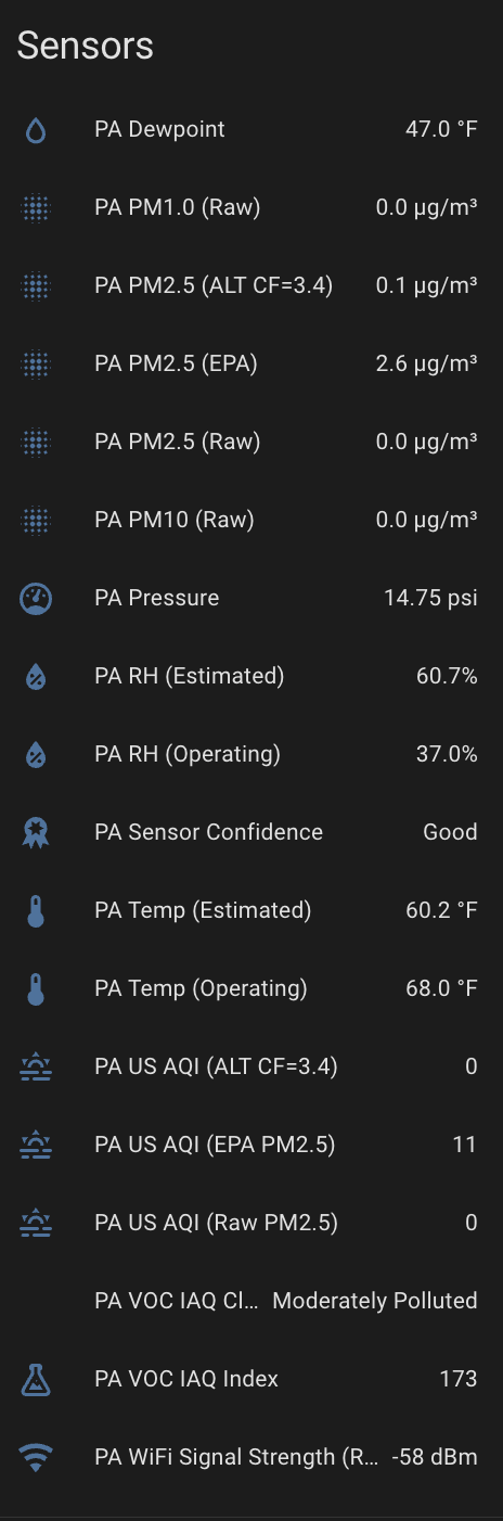

Wanted to share that I forked the @ryushi repo and incorporated the EPA and CF=3.4 corrections for PM2.5 readings. Also added VOC readings and updated the Temperature and Relative Humidity equations with PurpleAir’s current formulation. For completeness, I output the raw and corrected values for PM2.5, AQI, Temperature, and RH. Previous forks weren’t incorporating these corrections for some reason, but PurpleAir gives you the option to display this data in their public map. Let me know if you have any questions. https://github.com/cosmic-driftr/home-assistant-purpleair
