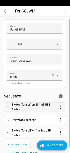

Write a script and call that from the button.
Script location ? automations.yaml
Use the UI. It’s good these days.
Will end up looking like this, but with your switch (sorry, misremembered your handle):
Thanks , script in OK and it runs, but clicking on the button linked to the script just brings up another box and I have to click on “run”
OOPs my fault , I select default action and not toggle, toggle works
Thanks
