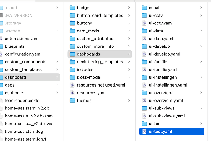

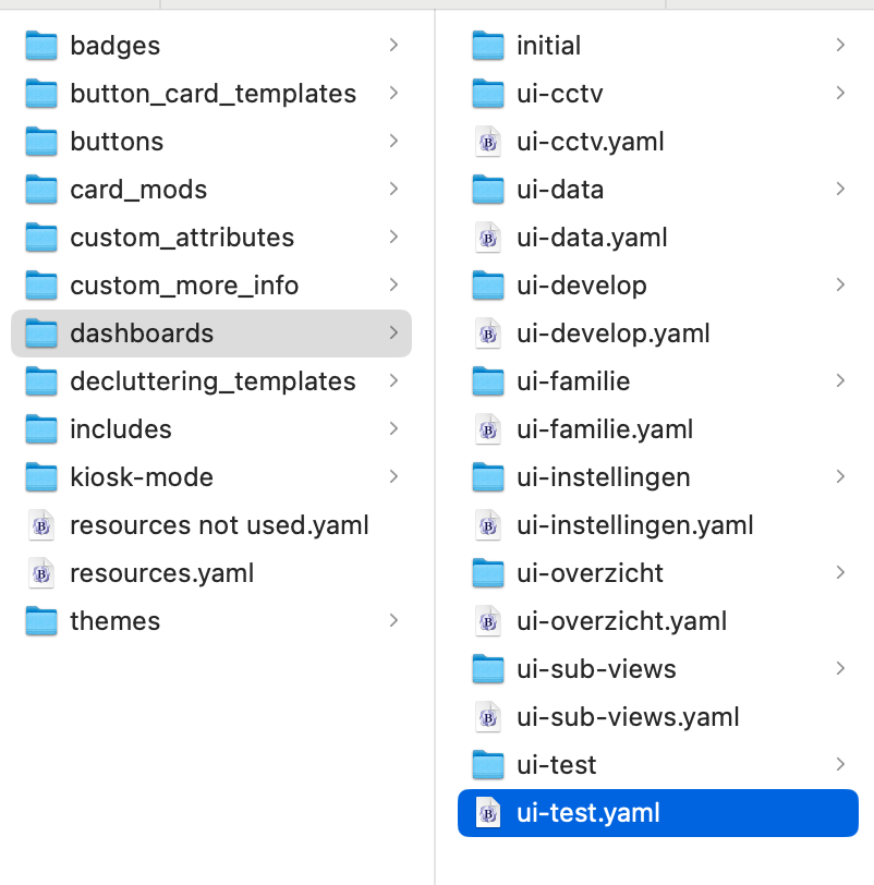

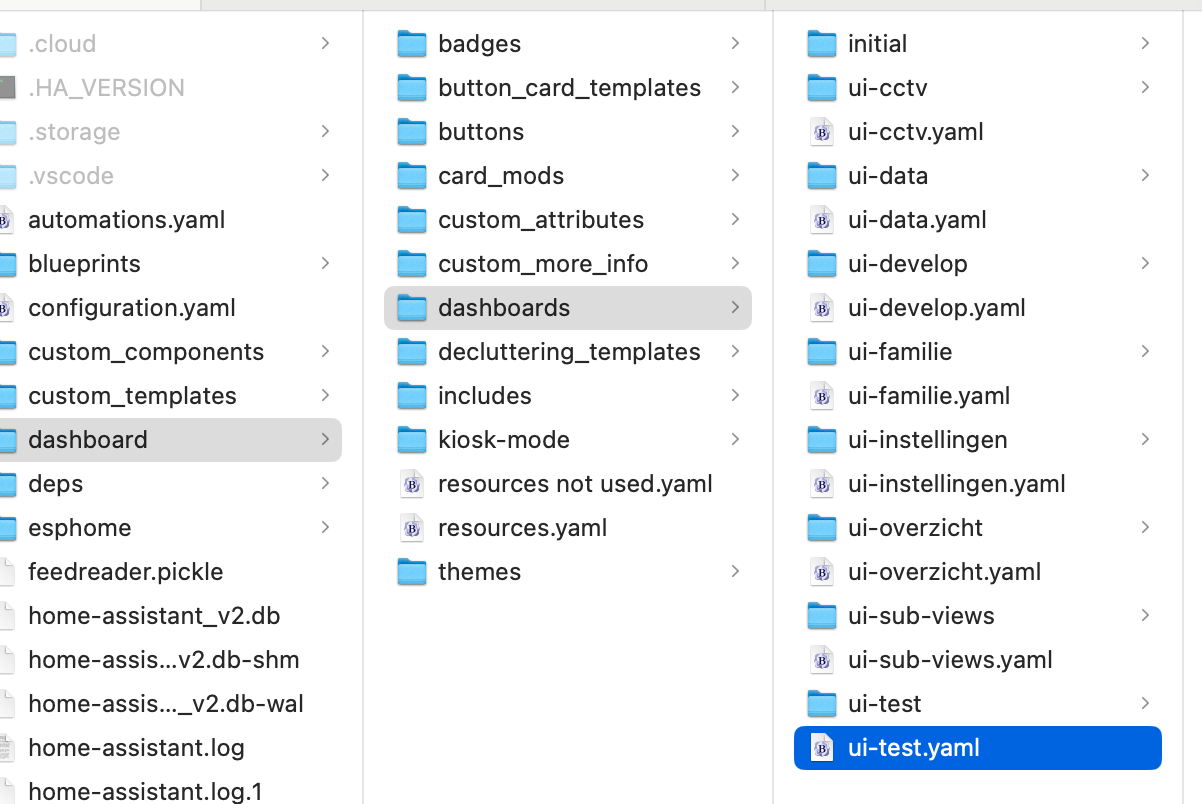

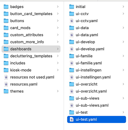

check this organization
in the highlighted folder I have this:
# Dashboard Settings configuration file, simply drop in a view, and ordered by number
# in the folder
# @mariusthvdb
# require_admin: true set in package_dashboard_config.yaml
button_card_templates: !include_dir_merge_named ../button_card_templates
decluttering_templates: !include_dir_named ../decluttering_templates
kiosk_mode: !include ../kiosk-mode/kiosk-mode.yaml
custom_more_info: !include ../custom_more_info/custom_more_info.yaml
keep_texts_in_tabs:
  enabled: true
  mobile_config:
    enabled: false
  override:
    - Test 2
    - Test 10
  exclude:
    - Map mods

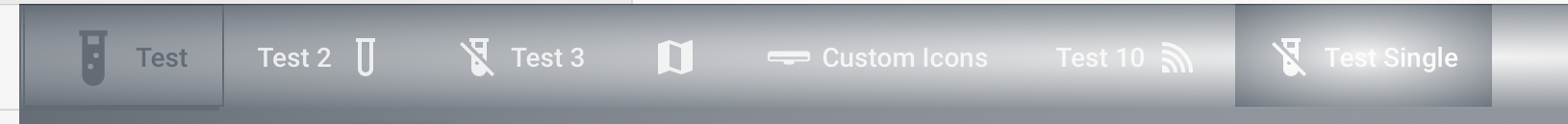

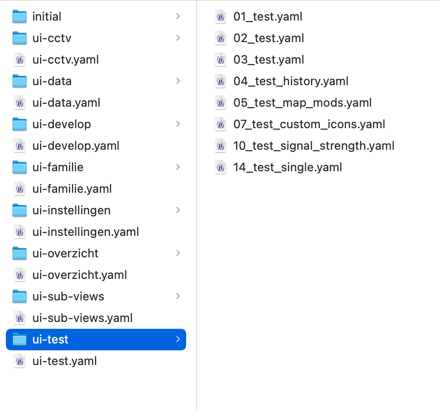

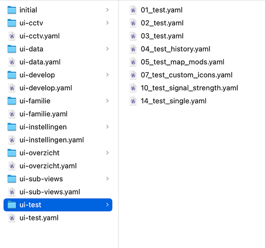

views: !include_dir_merge_list ui-test
which makes these folders show up as tabs in the dashboard
so, just make sure the position in the structure from which you reference the include is correctly pointing to the path of the folder you require.
also check the other includes, with the leading ../
they point to the folders below this:

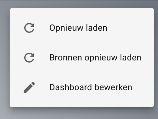

that would be not what I see. I can change anything in the yaml, and a reload (‘opneuw laden’ top right menu 3 dots)
will immediately take effect

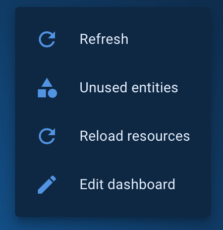

Interesting. I didn’t use the 3 dots on top of the page, but triggered the reload from the developer menu. Just tried it with the 3 dots “reload resources” to see if it makes a difference.
I edited the displayed text in my view. Requested the reload, confirmed the question to refresh the page… nothing changed. Then CTRL+F5 to force a browser refresh… no change. .
Did the same exercise 3 more times, text remained unchanged.
After this, opened the file containing the include. Added a space to a comment line and saved it. Reload resources… no change. CTRL+F5 change became visible.
It really is very reproducible and seems HA checks if a file was changed before processing (and not taking the includes into account)

no that wont do it, you really need the ‘Opnieuw laden’, which is the ‘Refresh’ menu item in English
And indeed a plain browser window reload doesnt kicking the yaml changes either,
