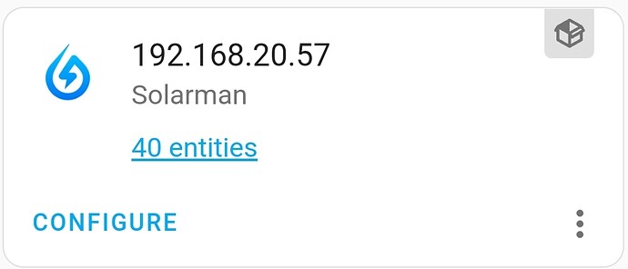

That gives you the following 40 entities:

Screenshot of the integration
Screenshot of the direct connection to the dataloger
And HA does not want to connect (Not even talking of the sensors. It first needs to connect)
I really don’t know what to do more to get this working. First step is in getting it to connect.
