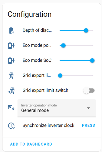

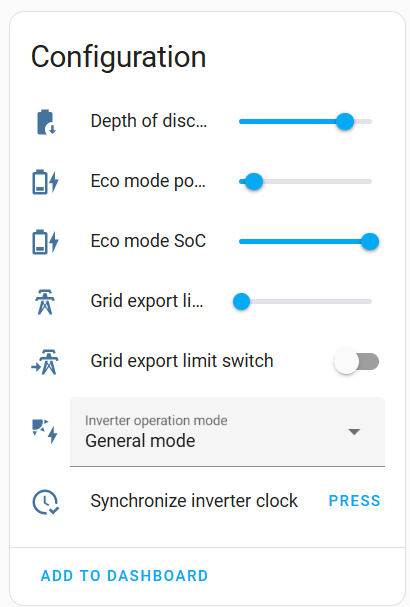

For the Disable Overflow, I love the idea, but I don’t see Export limit in W in my integration, I only have the % one (currently set to 4% by the guy who installed the system), with 200% being the maximum, but even at 200% it still exports to the grid.
Thanks for your note! I didn’t notice there is more possibilities in GoodWe integration how Export Limit is defined. It depends on family/model of the inverter. From which family is your GoodWe inverter from?
I’ll try to add possibility of using percentage Export Limit number very soon.
Hello again! If you’re interested, I added also Export Limit in % to the Disable Overflow blueprint. Don’t get confused, in README at Github the description of the blueprint is updated but here at the community forum I can’t change the description at the moment. Can’t wait for your notes and experience!
Hi, I do use official integration. What will happen if I switch to experimental integration? And how do I change?
Hi! With experimental version you’ll get new work modes, entities and extended functionality. Details are mentioned at it’s Github repo. If you switch to the experimental, all data and settings should not change, you just get new features. The first step for migration is installation HA Community Store to your system (you just find HACS in available integrations). After its installation you should find GoodWe experimental integration in HACS environment where you can add it to your HA.

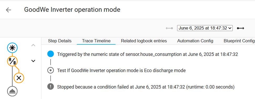

I cannot get template " Turn Off Eco Discharge Mode When Peak" to work. My goal is to not drain battery when changing my EV.
When template trigger.
"Stopped because a condition failed "
What I can see so is Inverter in “General mode”. Wrong mode?

Hi, exactly. Condition failed because of the general mode of the inverter. This template changes inverter mode from Eco discharge to General. Typical use case is selling energy to the grid while high price at spot market (Eco discharge mode) and sudden increase in household consumption. This is the reason why we typically want to change Eco discharge mode back to standard – General mode. I guess this template just didn’t fit your expected use case. I am also very sorry for a late answer.
