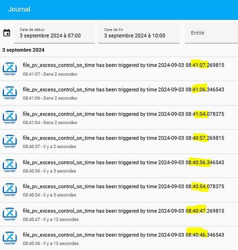

Thanks Henrik for this useful blueprint, Hi to the community !
In have implemented it and it is somehow working but I have 3 issues/questions
I went through this forum, but didn’t find the answers.
1/ in logbook it records logs between every sec or 10s, which is huge. (see attached file). Is it normal? And how could I reduce this frequency?
2/ Even after implementing the workaround of @stefan73, when I enable an auto, the action is not triggered even if all conditions are met and I have always to execute it manually, otherwise that action is not triggered automatically
3/ Why is the auto not immediately evaluated/executed when I enable an auto? Apparently it takes a minimum of 1 minute to perform the action even if all conditions are met
Thanks for your answers
