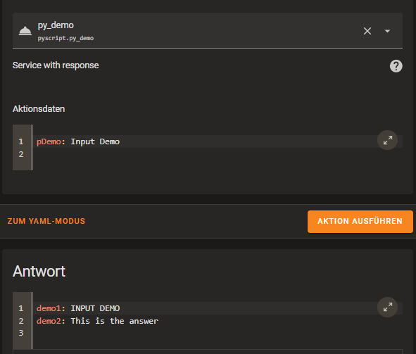

I would therefore like to post a complete solution here:
import json
@service(supports_response="only")
def py_demo(pDemo=None, return_response=True):
    "Service with response"
    response = '{ "demo1":"' + pDemo.upper() + '", "demo2": "This is the answer" }'
    return json.loads(response)
