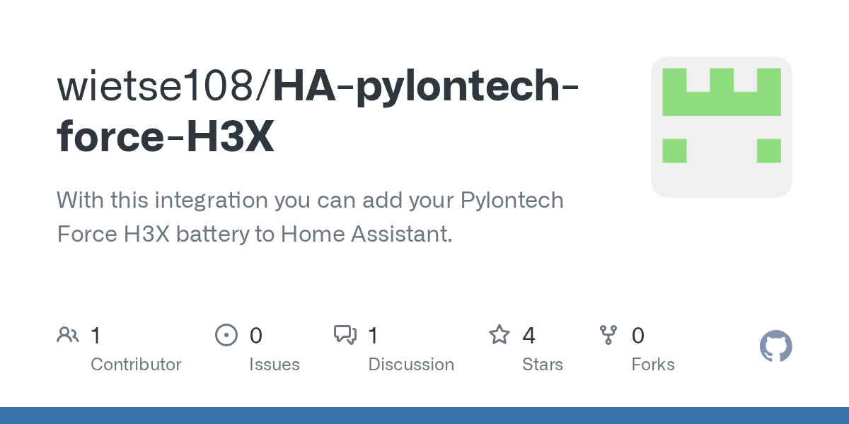

I have created a modbus yaml file you can use for integrating the Force H3x
