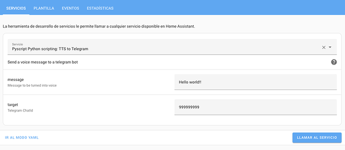

And the you can use it as a service:
Hope you guys like it! Cheers!
