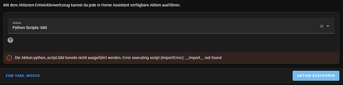

Error Message:

You can’t use import with the python scripts integration. Try pyscript or AppDaemon.
The other option would be to use the shell_command to run your python file and run it from an automation.
