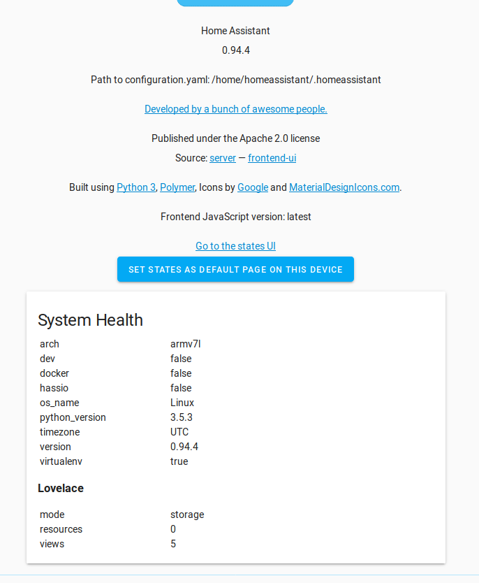

Hi. I try to update python with different command but still I have in the nofification area, when I update home assistant, the message:
python 3.5 support is deprecated and will be removed in the firs relase after August 1. Please upgrade Python.
Have anyone a solution?

My initial guide took 20 steps but it looks like you may have already updated Python in the OS. In just the OS what is the output of python3 --version and python36 --version ?
That would help me determine the next steps.
It appears you are part way there. We just need to verify that.
