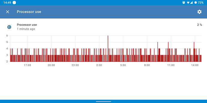

Thank you for your help. After the update cpu usage doesn’t increase :slight_smile:
The remaining known performance concerns that I’ve been tracking have now all been addressed in 0.115dev which is scheduled for beta tomorrow.
