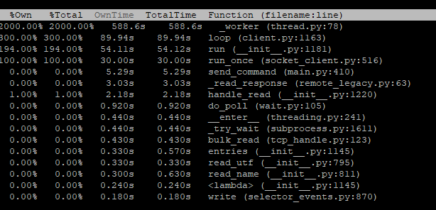

Some help in the Discord Chat pointed me to analyze the running python 3 process. I used a tool called Py-Spy for that. https://github.com/benfred/py-spy This allows you to profile a running process and even works with Python 3.6 and above.
Now I have a sample output from a fresh restart, and a sample output from several hours later when my process monitor actually shows the high CPU Usage.
However, I still don’t understand what processes are actually calling the different functions in python. Thought I’m sharing the results, maybe somebody has an idea on what is using so much of my CPU and how to fix it.
Freshly restarted:
Running for several hours:
A big difference seems to be the initialize connection (socket_client.py). Any Idea what that is?

Found it… its the zeroconf:
When i add this one back to my config, it immediately uses a lot of CPU power.
Without it everything is fine. Now to find out why.
