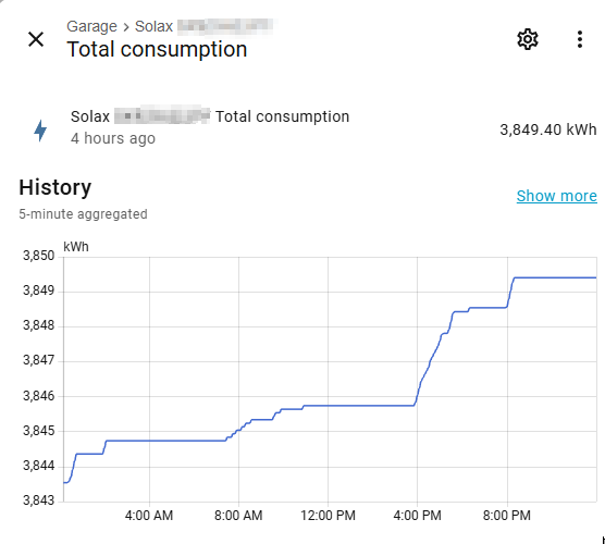

I noticed no consumption in the energy dashboard in HA for extended period of time, as shown here via the integration, and I am also getting the same flat (always same number for hours) reporting of On-grid total yield, On-grid daily yield, Total feed-in energy, Total consumption from the raw data, while power & voltage etc. are fine.
My current hypothesis is that QCell is messing up greatly: first the cloud API stopped working, now this Solax integration might not seem to be the solution as the inverter Q.VOLT_HYB-G3-1P is not returning good data.

The analysis from my Claude + HA-MCP, after comparing the data retrieved over the last 30 days from QCell REST with the data exported from QCell portal, which is aligned with the data from locally retrieved Solax integration:
The “home consumption drop” was never real. Your house was consuming the same as always. The QCells cloud API silently started delivering wrong solar data after the DST change, making the available energy appear ~6 kWh/day lower, dragging the Home figure down with it and turning the untracked from +30% to negative.

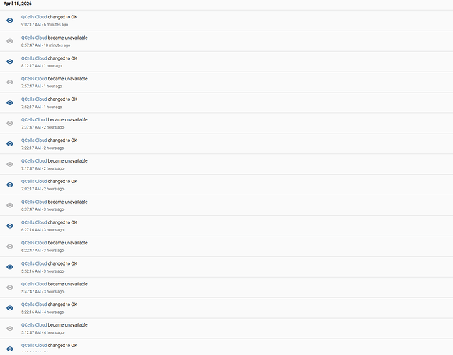

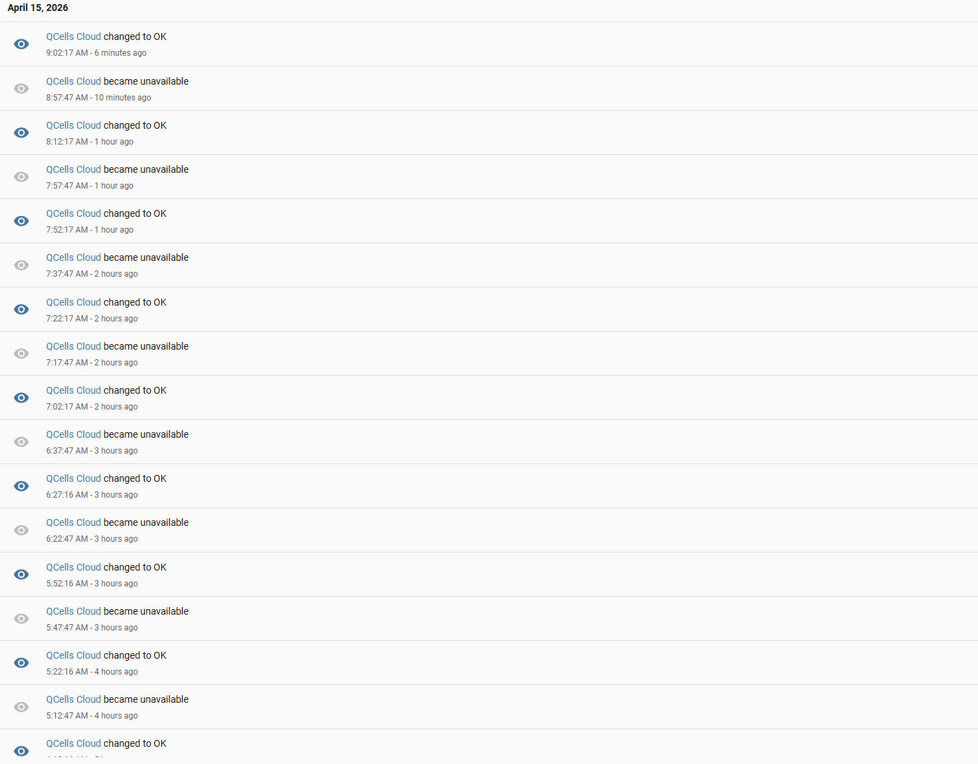

To clarify, the rest integration gets errors very very often which result in unavailable data.
I just changed the configuration.yaml from the first post to the new template/sensor syntax. Nothing else new, just new syntax:
