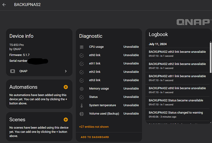

Yes, please do. I am testing to integrate one of my other QNAPs right now - it might be that you need to disable MFA while you integrate and then re-enable it. I will post my findings in a couple of minutes.

Yeah, I was wrong. I tried removing MFA on my other NAS, integrated it successfully and re-enabled it, everything went unavailable. Been years since I set it up on my main NAS, I see now that I’ve created a separate non-MFA account which I use for the integration. Sorry for the confusion!
