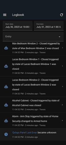

I been running qolsysgw with Appdemon / MQtt and now I’m getting something weird going on. I will get tons of notifications that are set up in my automation and when i look in my home assistant logs I get “qolsys Panel last error become unavailable” then it comes back online and sends every available automation that is set up with the panel.

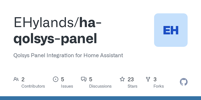

No problem I stop using this and start using this with out any issues and super easy set up.
