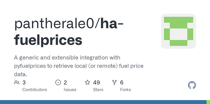

Is there any chance someone is working on a HACS integration?
check out the “Fuel Prices” integration - works very well, and you can specify areas, and a radius around given lat/long
Thanks, I’ll have a look at it.
