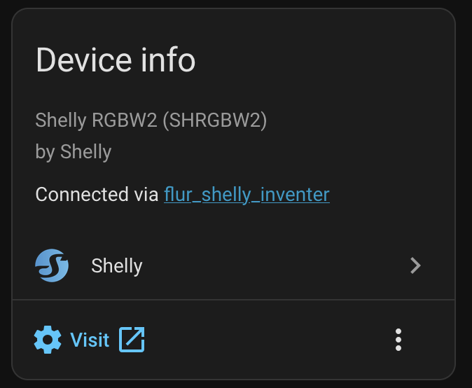

Actually I find it pretty elegant not to have to use the IP in the name: often when you are on a DHCP network and your device changes it's IP (which might happen), Home Assistant will just continue to work like nothing happened. Most of my IP devices use CoIoT/CoAP or MQTT, so HA will still find them.
If I want to check on a device, I usually just use the "Visit" button on the devices page - it's faster than finding the IP on the router e.g.
