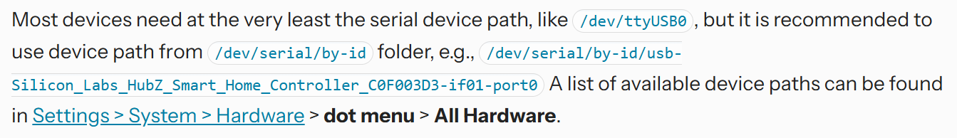

Aside from the suggestions of getting a powered hub, your issue could most likely be the fact that the USB path for your devices changed when you plugged them into a different USB port.
It’s explained here in the ZHA integration docs and likely also applies to ZWave integration config. Basically, change the config to use serial/by-id and you shouldn’t be affected by USB port changes:
