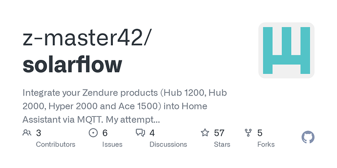

Yesterday I tried to add my cluster of two Zendure Hyper Devices via MQTT. For this I used the following guide:

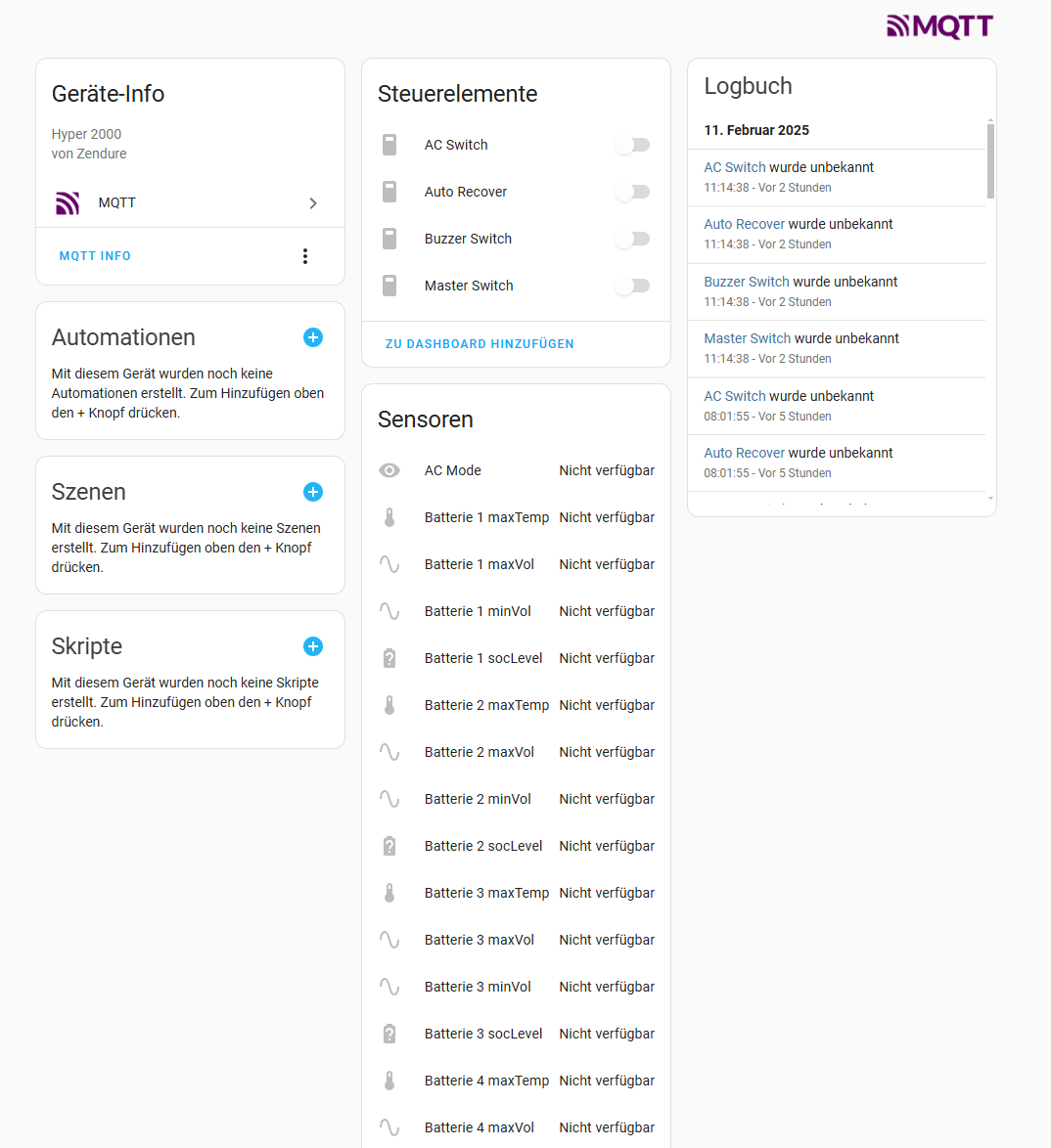

Now both Hyper devices are listed within the MQTT-Integration, but only one shows values for its entities. The other one only lists “not available” for all entities.

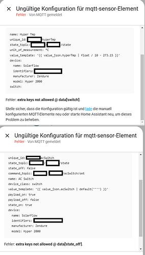

In addition to that the partly working device still shows two configuration-errors for the .yaml-file, which I don’t understand.

I changed the
mqtt: !include_dir_merge_named zendure/
line to:
mqtt: !include_dir_merge_list zendure/
Now the two mqtt config errors are gone.
Unfortunately I do not get any data from any of the two hyper devices now.
