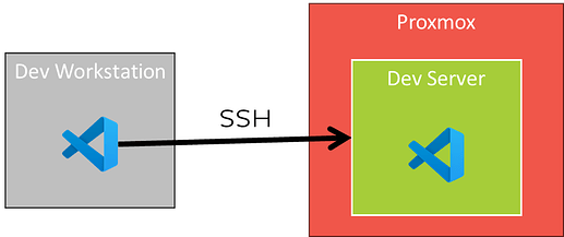

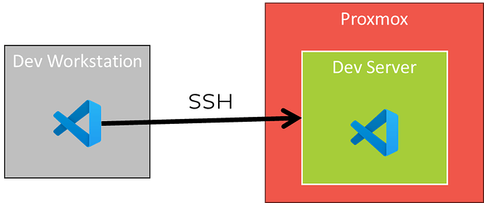

  • Am I correct to see the setup like this below?
  • I don’t see you mentioning installing VScode on the Dev Server, is that correct? Just SSH from VsCode on the Dev Workstation to the cloned Home Assistant repo and it will suggest to make the devcontainer?
yup

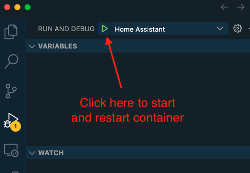

The dev container is running now, but HA still needs to be started and restarted after making changes to your code from the Debug Menu.
