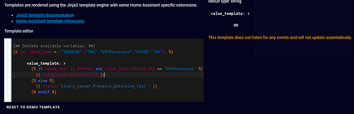

Try the second value template with “D3F9xxxx…” with the " "
It works in Developer Tools Template
