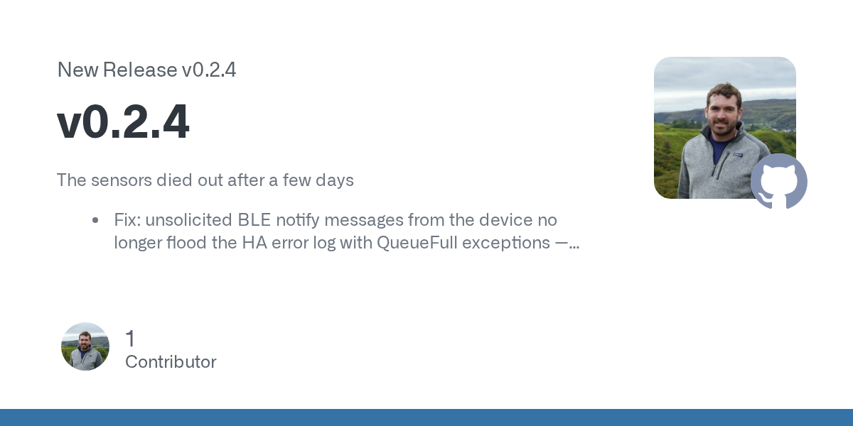

My sensors died out after a few days, pushed up a new release which hopefully fixes that without the need to restart HASS

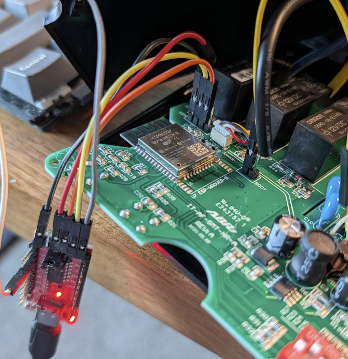

Did anyone explore the fully custom firmware replacement option for this controller?
I spent an evening reverse engineering the stock firmware, and it seems pretty easy to replicate it with a custom ESPHOME firmware that will work via Wi-Fi and will seamlessly integrate into Home Assistant.
It appears to be possible to instruct the device to update from your custom OTA URL via BLE. I didn't test it yet. However, if it works, then anyone can switch to the open source ESPHOME firmware (and back) even without physical access to the device (one first initial pair with your phone would be still needed, but most already have it).
BTW, the controller is using ESP32-WROOM-32D module and has UART + BOOT pads on the PCB, so manual flashing/recovery is also an option with FTDI.
I just got mine recently, didn't plug it to a fan yet and exploring / testing it on the bench. I checked the BLE HA integration project and ESP32/ESPHOME relay project, but it looks like native ESPHOME firmware would be a nice option too. It can also support both BLE + Wi-Fi modes and be compatible with the stock app in theory (but since I don't plan to use the stock app anyway, I'm not focusing on this task).
At this point I did 90% of the stock 4.1 firmware reverse engineering, got the pinout for buttons, LEDs, dip switch, relays and temperature+humidity sensor. The next step would be creating ESPHOME config and testing it on the bench. Then I'll try to prepare an OTA update website for easy switching from the stock firmware.
I had ran into this issue a week or so ago, but then released a new version that should have fixed it:
Mine has been running completely fine since this new release. But, if you are on 0.2.4 and still encountering errors. Send them my way and I'll take a look
