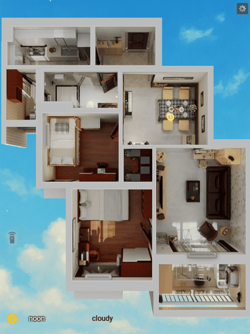

It is not just a floor plan card, but a spatial perception engine. RMM maps data from multiple scattered millimeter-wave radars in your home onto one or more floor plans, enabling whole-house human tracking, trajectory visualization, and precise coordinate-based automation.

1. :bullseye: WYSIWYG Visual Editor
Ditch the tedious YAML coordinate calculations! RMM provides an interactive frontend editor:
  • Config/View Modes: Supports Config Mode and Read-Only Mode, allowing for both easy setup and clean display.
  • Multi-Map/Multi-Floor Support: Manage multiple floors and locations easily with map_group, creating independent views for your home or office.
  • Flexible Radar Configuration: Drag and drop radar positions directly on the floor plan. Supports rotation, scaling, and mirroring for one-stop management.
  • Automatic Positioning & Scaling: With the Freeze function, you can visually locate a radar target relative to the floor plan to easily adjust the radar scaling—goodbye to blind guessing.
  • Mounting Styles: Perfectly supports both Side Mount and Ceiling Mount radars.
