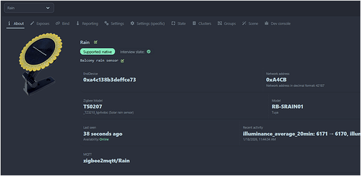

It will register changes as soon as I restart the Zb2MQTT addon or HA completely.

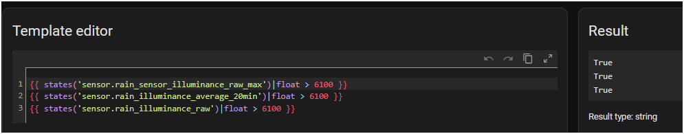

Why don’t any of the template checks won’t pass, even when template debug shows them all true?

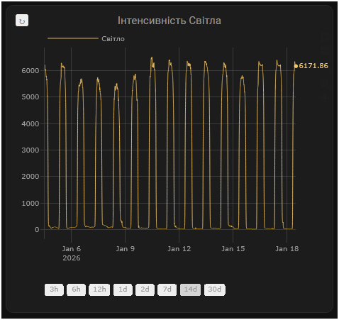

And the graph is working as expected:

type: custom:plotly-graph
title: Інтенсивність Світла
entities:
- entity: sensor.rain_illuminance_raw
filters:
- filter: i=1
- resample: 1m
- exponential_moving_average:
alpha: 0.1
show_value: true
line:
width: 1
color: rgba (255, 200, 100, 100)
logarithmic_scale: true
hours_to_show: 240
refresh_interval: 15
grid_options:
columns: 12
layout:
dragmode: pan
height: 450
margin:
b: 120
legend:
itemwidth: 80
xaxis:
rangeselector:
"y": "-.3"
buttons:
- count: 3
step: hour
- count: 6
step: hour
- count: 12
step: hour
- count: 1
step: day
- count: 2
step: day
- count: 7
step: day
- count: 14
step: day
- count: 30
step: day
config:
scrollZoom: false
doubleClickDelay: 600

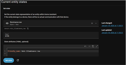

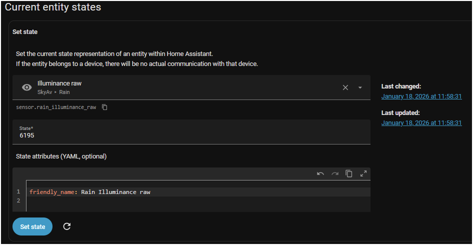

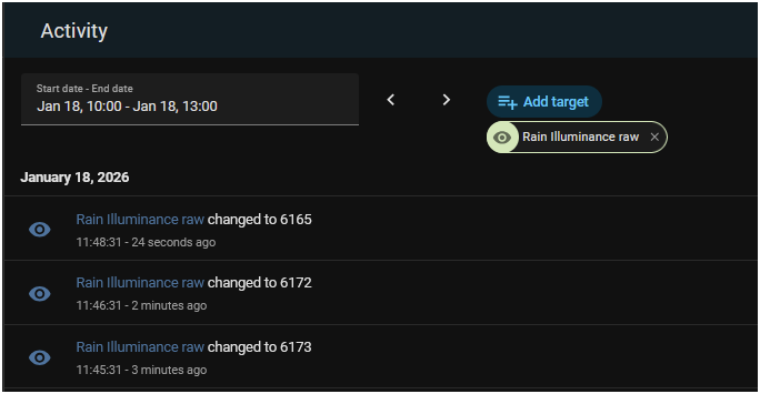

The activity is ok:
Last updated: recently and just fine.

- trigger: template
value_template: >-
{% if states('sensor.rain_sensor_illuminance_raw_max')|float > 6100 %}{{
True }}{% endif %}
- trigger: template
value_template: "{{ states('sensor.rain_sensor_illuminance_raw_max')|float > 6100 }}"
- trigger: template
value_template: "{{ states('sensor.rain_illuminance_raw')|float > 6100 }}"
- trigger: template
value_template: "{{ states('sensor.rain_illuminance_average_20min')|float > 6100 }}"

The device:
Zigbee Model
TS0207
_TZ3210_tgvtvdoc (Solar rain sensor)
Model
RB-SRAIN01
Related issues:
- The change to the existing illuminance sensor in the Tuya rain sensor (RB-SRAIN01) is not correct. · Issue #30439 · Koenkk/zigbee2mqtt · GitHub
- Issues · Koenkk/zigbee2mqtt · GitHub

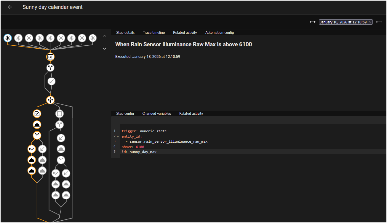

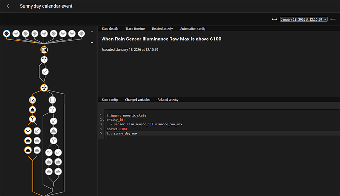

UPD: And as soon as I added one template sensor and reloaded configs, it triggered!
I added another template sensor just for testing:
template:
- sensor:
# Additional state class change
- name: "Rain Sensor Illuminance Lx Fake"
unique_id: rain_sensor_illuminance_fake
state_class: measurement
state: >
{{ states('sensor.rain_illuminance_raw') | int }}
UPD 2: The fake Lx sensor fixed the issue; it now triggers as expected.
