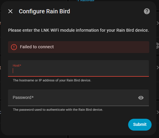

I am unable to connect a Rain Bird RC2 via the Rain Bird integration.
It starts with adding the integration. When I add the Rain Bird integration, the 1st screen pops up to configure it (Configure Rain Bird), where you add the Host IP (which I already reserved via DHCP for the RC2 and confirmed the IP and MAC with a IP scanner) and the Password (The pin that you specified when you add the RC2 to you cell Rain Bird app).
Once you submit the details, everything gets cleared and you get a massage stating “Failed to connect”.
The only option you have is submit, which fails, or to close the “Configure Rain Bird” window which then does not add the Integration. I wont be able to enable debug logging for an integration that wont add.

Is this your first time trying to connect your Rainbird RC2 controller with integration?
Did you type in the actual IP address on the configuration screen first?
Does the Rainbird supplied app on your phone still work?
Is everything up to date, on your HomeAssistant, HACS, Rainbird integration, as well as firmware?
Are there any related entries in your system log? DNS log?
Do you have any VM’s, VLANs, firewalls, or other complicated networking customisations?
