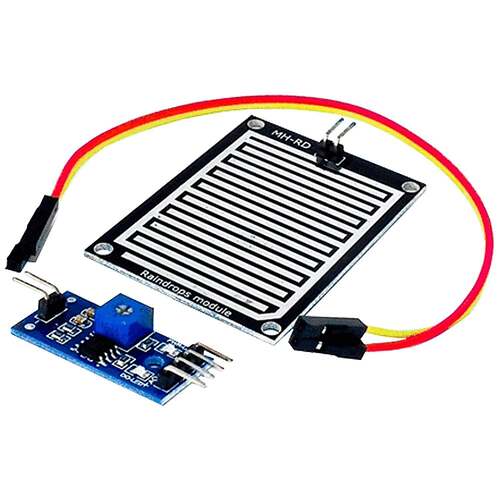

I do not think you will find many zigbee pre built ones, so this is likely why you see mostly diy things. You could buy a cheap door sensor and wire a sensor like this to the place where the reed contact is that responds to the magnet. That isn’t hard.

Do note that the ones based on electrical contact by water will corrode over time and need replacement at some point. But since they are cheap, that should not be a big problem. They also tend to take some time to dry and stop signaling rain.
