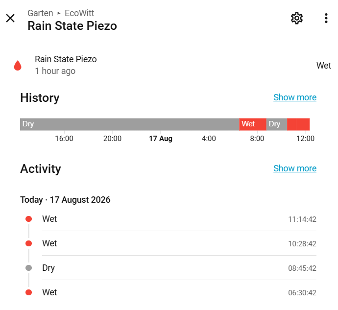

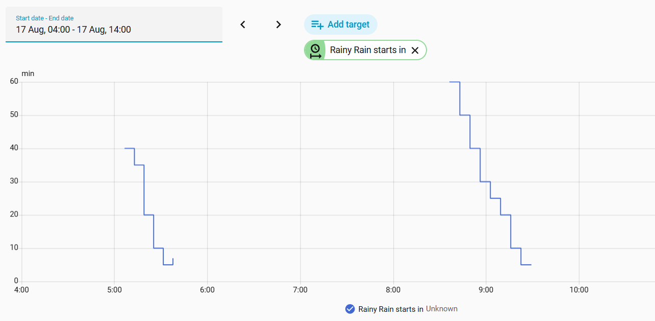

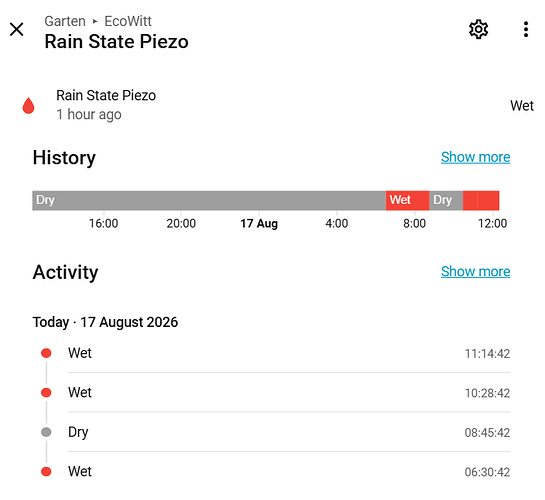

Now that it’s raining again in Switzerland, I am finally able to test your integration. Besides stumbling over 6minute 100% CPU spikes and not being able to use pysteps because HA went a bit early to python 3.14, I noticed a strange pattern in the time interpretation.
It predicts rain pretty well, but is almost exactly one hour off. it said it would rain at 05:32, it actually started at 06:30. now it predicted it would rain at 09:30, it is 10:00 and no rain in sight, but other services predict it will rain at 10:30, and I’m sure that’s when rain will hit.
Lo and behold, at 10:30, it started raining.
If I interpret the README correctly, the timestamps are in UTC. My location is set to Europe/Zurich, now() correctly reports CEST adjusted time.
The starts-in cut off exactly an hour before rain actually hit, my rain sensor for reference attached.
What am I doing wrong? I can’t find a Stellschraube to adjust. Perhaps you could point me in the right direction?
