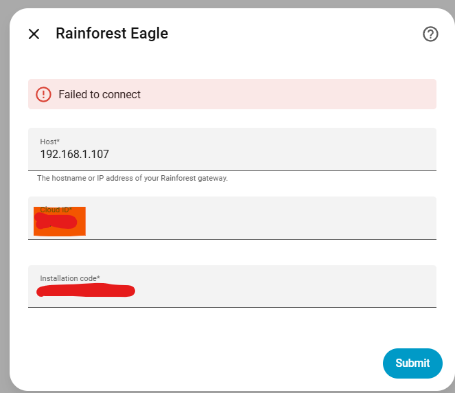

I got a Eagle 3 from my power provider, I want to try and connect it to my Home Assistant but it wont add
I am able to post the following and get basic sensor data out of it

However I cant control the smart switch or read the power data
this commands like get_summation i just get the response
<Error>
  <Description>Duplicate message</Description>
</Error>
