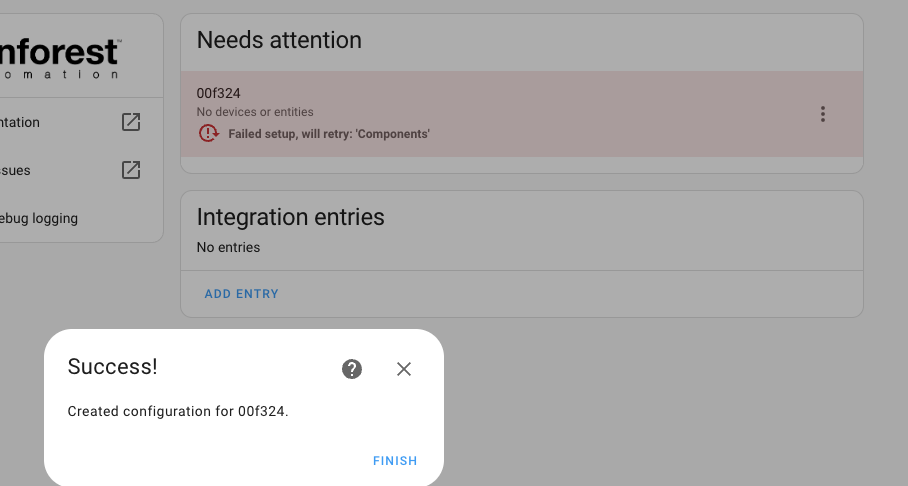

Hey I just got one of these devices for free though a promotion from Flowpower an australian energy retailer.
I would like to be able to connect this device to HA, but I cant seem to get the configuration to work.
I think i have hit the IP address snag. It is showing up as 192.168.1.32 on my router and auto discovering via the rainforest eagle integration.
But I cant get it to connect with that IP address, listed under host.
Anyone have any pionters?
here is a screenshot of my setup,
I used: 192.168.1.32
and the cloud ID and IN: from my device
It adds successfully but then “Fails setup” related to Components .
I’m running into the same issue. IP from my router and cloud ID and IN from device, but I get the same error - Failed setup, will retry “Components”.
