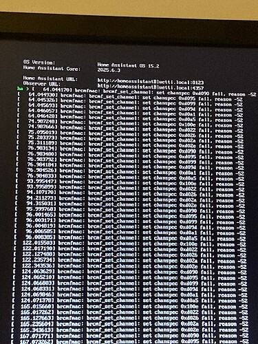

Disable your WiFi
Slt Francis,
I use the natif wifi of rasberri, but if i disable it won’t do the job (I use it to monitor the home power battery backup). Or maybe i can find another usb wifi ?
The Home Assistant server works best when connected to the router or switch by Ethernet. WiFi is strongly discouraged.
ohh Thanks! I see… It is really good to know. I think that may also explain the another problem : if ever we have a power cut and if the rasberi have to reboot, it simply won’t reboot :-/
