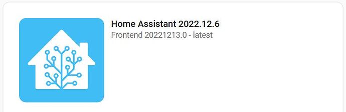

Now I have version 2022.12.6 installed but unfortunately with some errors for some integrations:
cloud, mobile_app and default_config
see from line 1487 in logfile
For this I need some suggestions how to solve because my python version is 3.9.2 and NumPy version.
