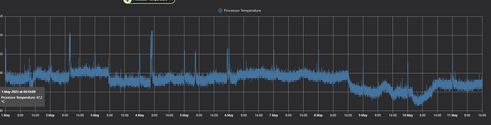

Sorry, should have used the newer screenshot:
as you can see it is still going on.

Looking at the CPU load of the RPi I noticed that the load is at least 25% at all times which looks like one core is at full load which would explain the jump in temperature. I just don’t know how to find out what exactly causes the CPU load.
Update: after looking through all my addons I found out what is causing the load spike: Silicon Labs Multiprotocol (Version 1.1.1) from the skyconnect stick. No devices connected at the moment.

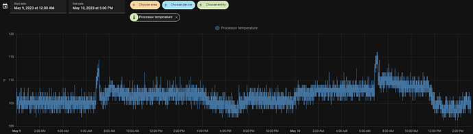

Mine’s even better than it used to be (now something bad will happen… ugh!). The slight spikes around 7:05am every morning is an automated full backup. Since it is an RPI4B w/8 GIG of RAM running on a 1TB SSD, it used to crap out about once a week for no apparent reason which is normal these days on the RPI with HA evidently. I automated reboots as well with some widgets on a dashboard that allow me to set the day of the week and time for reboot. It has been running like clockwork ever since. I can’t believe how well it is running considering I have HA Supervised with maybe 200 sensors (about 250 automations) as well as daemons running on the host outside of HA transmitting weather data all over the world using weewx from an AmbientWeather WS-2902C weather station:
It’s typically running about 5% CPU:
and 105-107 degrees F:
