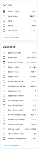

I think it was something to do with the power supply of the PiJuice. In the end I splashed out for this device: https://www.amazon.co.uk/dp/B0828G42KN?psc=1&ref=ppx_yo2ov_dt_b_product_details
Screenshot of sensors and diagnostics exposed in Home Assistant are as follows:
