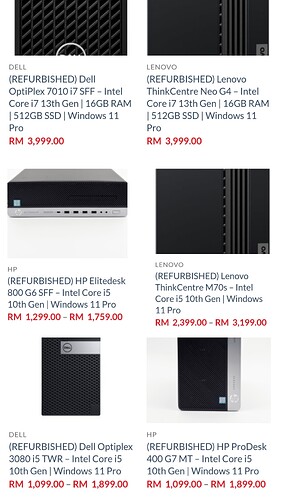

I hope it’s okay to continue on this thread, are these PCs good candidates? How far back is it okay to go on processor gens?
If they meet the minimum specs as shown in the docs, they should be fine.
