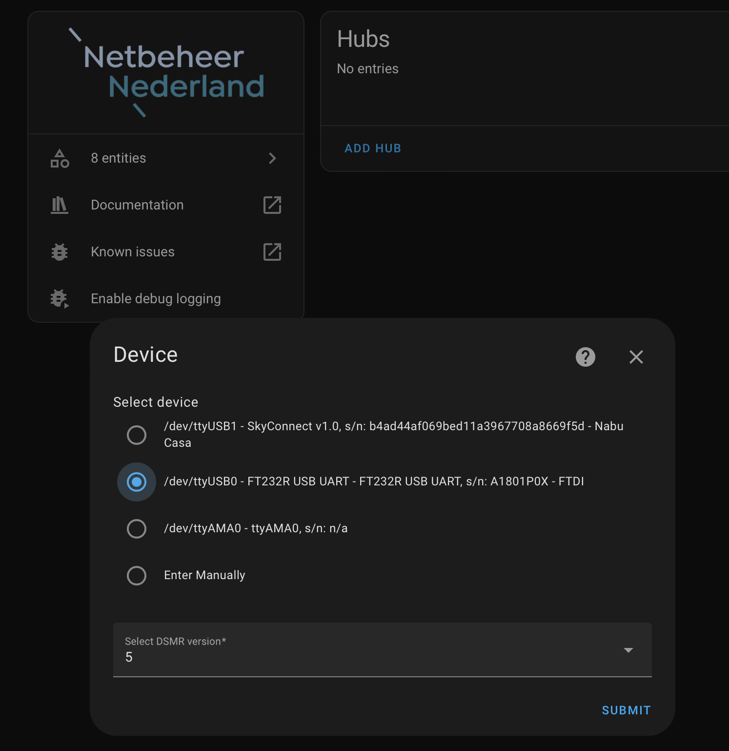

Mind if I ask a related question? I indeed see the same issue. I do see the 2 serial ports in the 2 USB ports I use in /dev/serial/by-id. But I cannot. specify that in the application in HA (see attached screen shot). Is there a work around for this
– Paul
